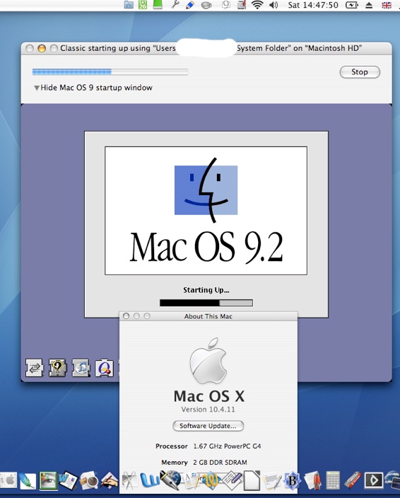

I was going to post an image here showing My PPC MacBook running Tiger with Mac Classic (Mac OS9) as a guide, with some notes to help ... but 'img' posts aren't allowed.

Here we go - (I added this picture via the boards Attachment feature) - If you have Tiger you can run Classic and that should be what you need to run your Mac OS9 application.

You are quite correct. I have a PowerBook G4 - An error on my part due to running a range of old Macintosh Laptops and mistyping the model.
